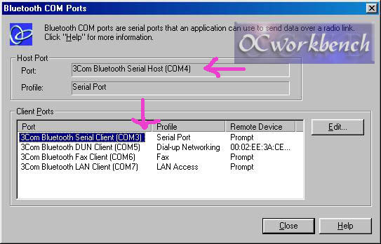

1.    Before installing the PC Suite, run 3Com Connection Manager. Click on Tools > COM ports and note down the Host serial port and client port. Exit 3Com Connection Manager. *I would recommend that you remove it from your Startup folder, so that it will not load by itself*

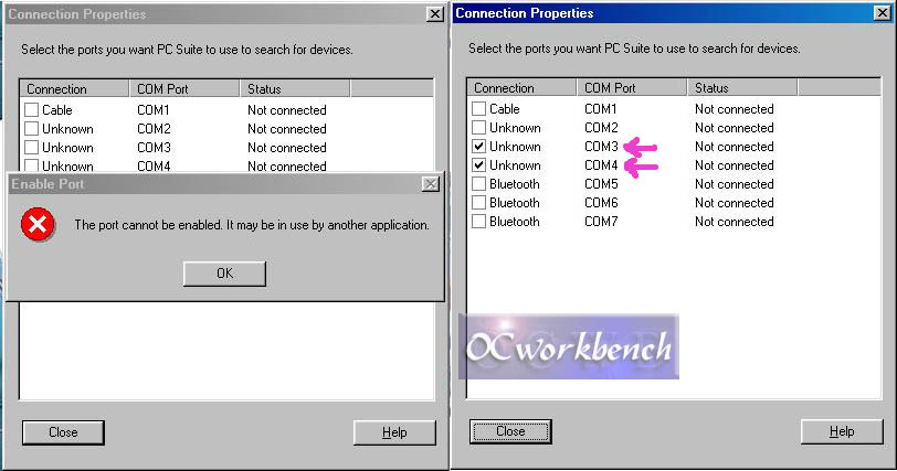

2.    Install Nokia PC Suite. After installation, you should see this icon called mRouter. Right-click on it and select Properties. Check the COM as noted down by you in step 1. If you get any eroor message, ignore it and keep checking it till it goes thru.

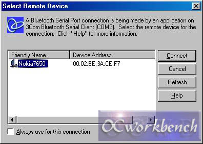

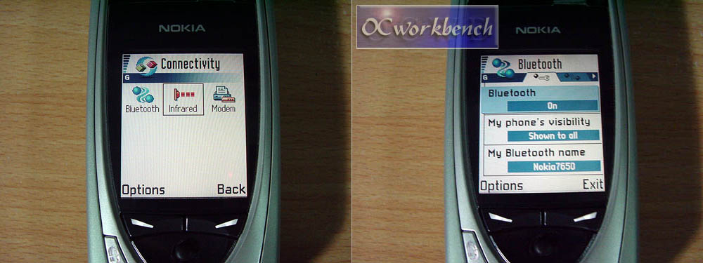

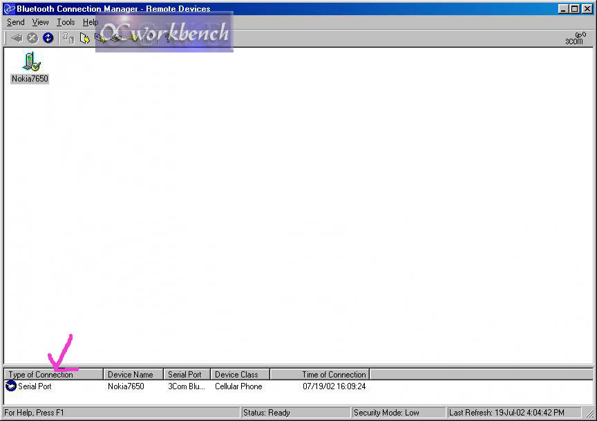

3.    Switch on BT in your 7650. Run 3Com Connection Manager and you should see this screen. Wait for 'Nokia 7650' to appear. Highlight it and click Connect.
4.    This will appear on your phone. Key 1111 or any other passwords.

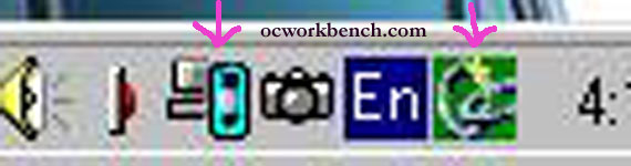

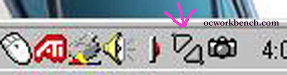

7.    The icon for mRouter will change to this and in 3Com Connection Manager, you must see the serial connection.
