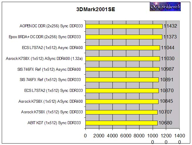

3Dmark2001 SE Build 330
ASrock K7S8X does not seem to do too well in 3DMark2001SE. It looks like there the BIOS is not fine tuned for performance yet. As you can see from the chart, the ECS L7S7A2 and SiS ref board shows that a high of 11,000 3DMarks is possible with this chipset.

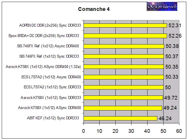

Comanche 4 Demo
In Comanche 4, we see a similar pattern. It seems that the BIOS is not well tuned in the 3D performance. Hopefully, Asrock will be able to fine tune future BIOS to improve it.
