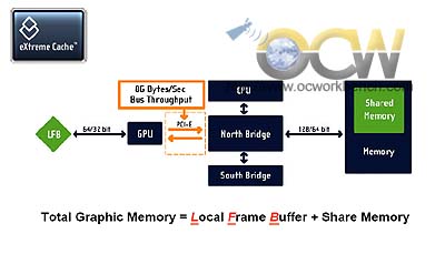

The Volari 8300 is the economical solution for home entertainment as it support eXtreme Cache Memory Structure. The software driver allows users to access application of the ControlDeck. With CoolPower II Technology, Volari 8300 decreases the power consumption and increases better video image and performance.
This card has 300MHz engine and 300MHz clock speed. The eXtreme Cache Memory uses 64 bits DDR memory. Max 256M Local frame buffer size. It also has flexible frame buffer configuration with local memory and shared system memory. It supports up to 512M total frame buffer size.
