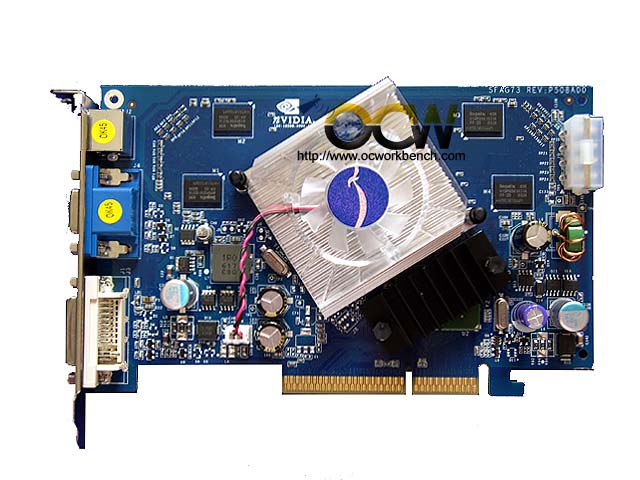

The AGP 7600GS requires a molex power connector which is not required in the PCIE version. Another disadvantage is that SLI is not supported. The card has layouts for GDDR3 memory drawn out on the pcb, so an AGP 7600GT might use the same pcb.
The card comes with a simple heatsink with a small fan(reckon it's 40mm or less). It provides totally no air flow to the HSI chip which can run pretty hot when stressed with 3D apps/games. During testing, I found that the core runs at 57C idle & up to 76C in ATI Tool artifact tester. As my 7600GT does not even exceed 60C under load, I suspected poor cooler contact with the gpu or a dead fan. The fan was spinning when I checked so I set off to remove the cooler.
