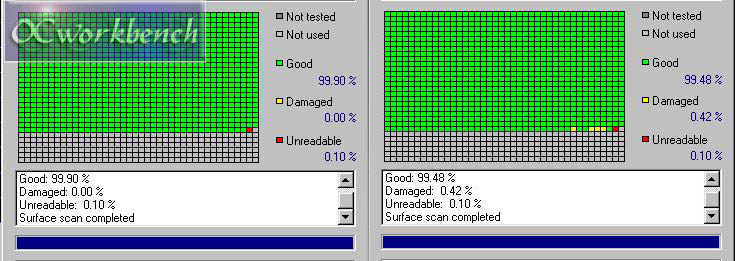

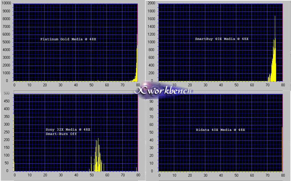

   To verify writing integrity, I ran Nero CD Quality test on all the burned CD-Rs and shown below are some screenshots of errors detected during the last 5-10mins of every burn (the rest of the discs produced similar results). We can see that current CD-Rs on the market ain't really capable of 48X speed even when Smart-Burn deemed them capable. However, the Ridata 40X media fares pretty well and is my current favourite for burning at 48X (very low error rate as compared with the rest) and should also be on your shopping list.
    Using Nero Scandisk, the detrimental effect of the 'slow down' toward the end of the burning process is evident as shown below.
