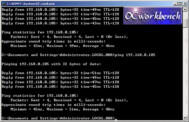

Within seconds we were connected. A new subnet 192.168.0.0 is formed. The client and server are in the same subnet bearing IP address 192.168.0 105 and 192.168.0.1. This is a piconet. As each client/server or master/slave pairs can be master or slaves of another machine of another pair, the piconets can be enlarged and will formed a larger scatternet. An Average ping time of 48ms is achieved which is something like our timing from my ADSL 256/512k network ping time to a MSI TW website.

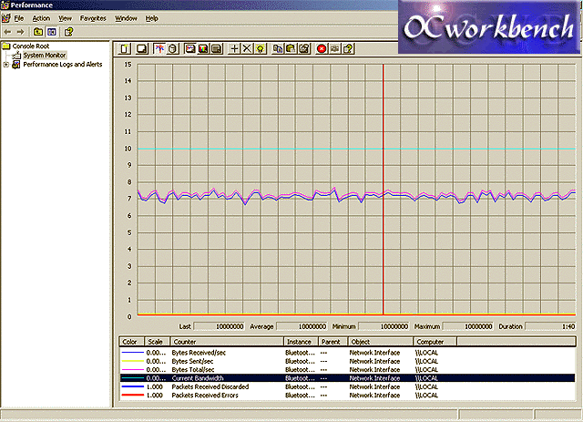

Using Performance monitor on the W2K, we look a the Bluetooth Network interface Object and check out the various counters it exposed. As you can see from the chart below, there is basically no discarded or error or drop out bytes. The pink colour line indicates the bytes total/sec. The Blue line indicates the bandwidth. From the chart, we can see that the theoretical bandwidth is not met, the sustained bandwidth is around 0.7 x bandwidth. (this test is done on the server machine reading the VCD .dat file across the bluetooth connection).

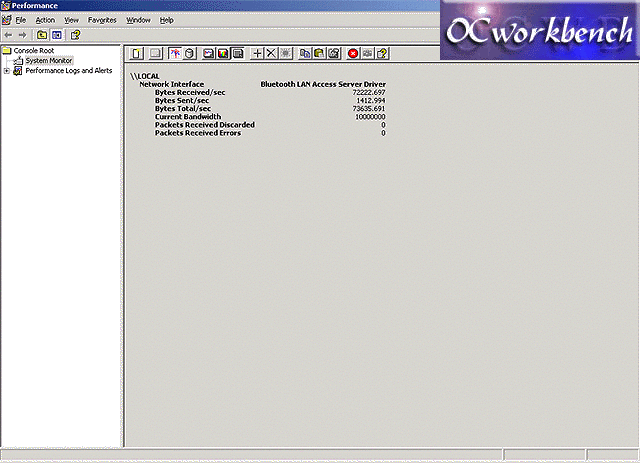

A look at the logs at the server PC shows that the Bluetooth LAN access server driver information breakdown. Do take note the figures are in Bytes. For easy computation, we take 1 byte=10 bits, thus bytes received/sec.
Bytes Received/sec 72222.697 Bytes  ~ 720,000 bit/s or 720Kb/s or 0.72 Mbps.
One thing I note about this information is that the value reflected for Current Bandwidth. It shows 10,000,000. There is no unit specified. If that is in Byte/s, that means it is 100Mbps which is not correct.
From our experiment, we can see that the speed of Bluetooth connection is around 0.7 Mbps. Bluetooth has a max of 1Mbps data rate.
