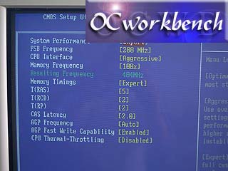

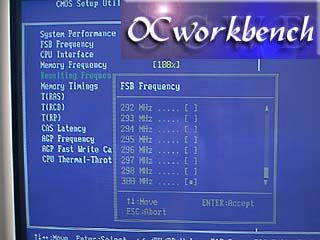

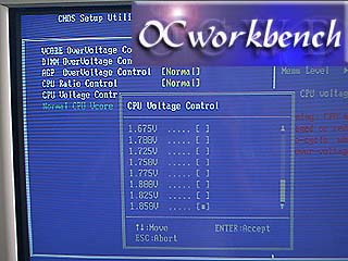

Under Advanced Chipset Features, we set the CAS Latency to 2, then 5-2-2 is set to precharge, ras to cas and ras precharge., Memory Freq is set to 100% that means run sync 1:1 to CPU fsb of 200mhz (barton 3000+ (400)). FSB can be adjusted from 100 ~ 300Mhz at 1mhz stepping. Quite a large range.

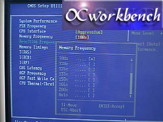

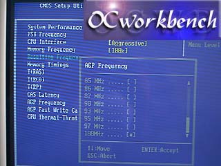

Memory Frequency Ratio can be set to run at at a ratio of the CPU. 100% = 1:1 The AGP can be fixed at 66, AUTO orany other settings up to 100Mhz.

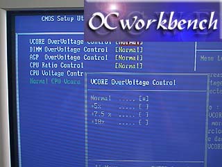

Vcore voltage can only be increase by 5%, 7.5% or 10% of its default voltage.

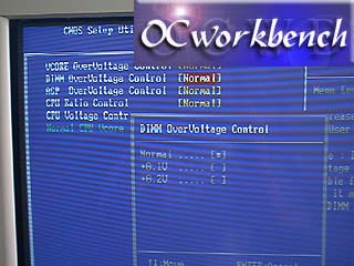

DIMM voltage can be up to +0.2v of default.

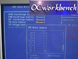

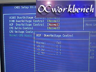

AGP voltage can be up to 0.3v of default. CPU Ratio is selectable up to from 5.0x ~ 22.5x at 0.5x interval
CPU Voltage control can be be set from 1.10v ~ 1.85v. Together with the Vcore Overvoltage control, the max is 1.85v + 10% (1.85) = 2.035v.
