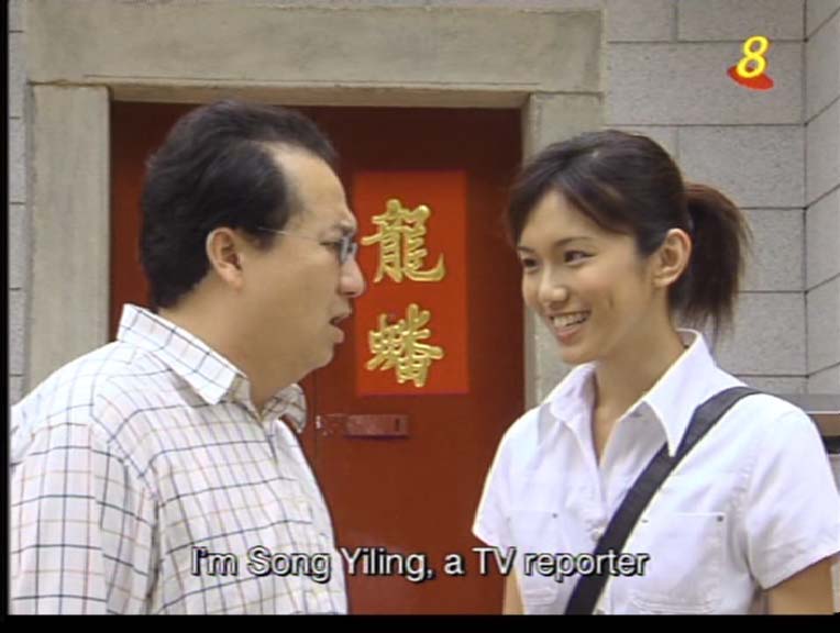

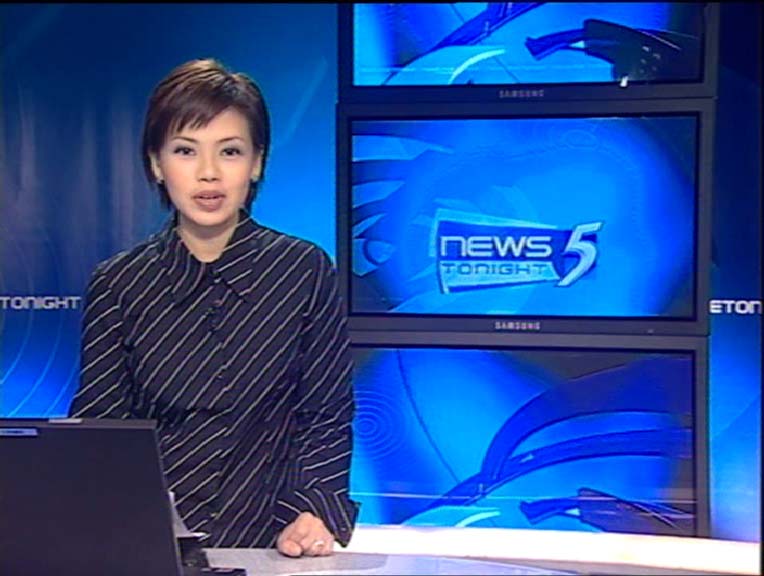

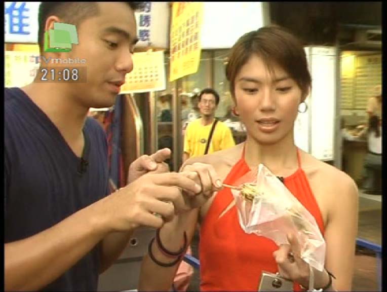

Screen shots.
Currently, the broadcasts are not in High Definition. All broadcasts are in SD. Although it is in SD, it is still far superior compared to the analog broadcasts that I receive via cable. The following are broadcasts from Singapore's Mediacorp test broadcast for Ch 5, 8, TV Mobile.
