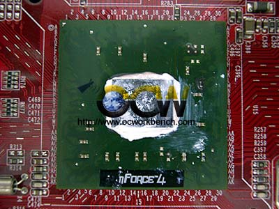

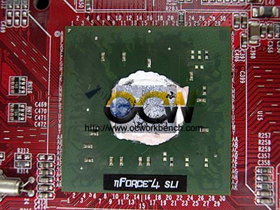

Today, we take a look at NF4 Standard chipset and NF4 SLI. To mod it to work in SLI mode, you might need to scrap off some of the portions of the connections and use a pencil to connect up the two points in between. Alternatively, you can use a silver pen to connect up the two points.
Below are screen shots of an actual SLI chip followed by the NF4 Std chipset. I used a pencil to interconnect two points on the NF4 STD and tada, SLI enabled.
NF4 SLI chipset
NF4 STD chipset
