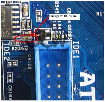

VDIMM mod to 3.04v
With the existing 939Dual-SATA2, default voltage level is too normal for overclockers. This project allows you to change a resistor and push it to 3.0v.
To do this, what you would need to do is to search for R3107 as shown in the diagram below. This resistor can be found next to the top left hand corner of the IDE1 connector. To do that, replace the 2.1K Ohm to 150 Ohm.
