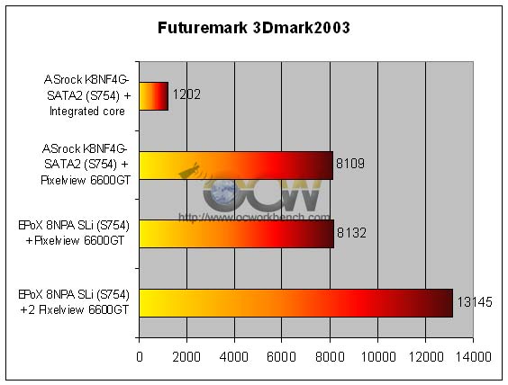

In this category, we tested the DX8 benchmark. Firstly, with the integrated core, a score of 1202 is obtained. Considering that we are using an integrated core, this score is actually very good. Most of the current integrated cores won't give you a score of above 1100 for 3Dmark03 test.
When we pair the board with a 6600GT, it is 8109 versus 8132. With 0.9 MHz slower, I feel that both boards should very close results when paired with external graphics card.

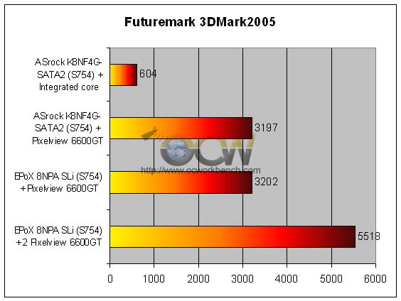

In 3Dmark2005, we get 604 3DMarks out of 3DMark05 using the integrated graphics. With an external 6600GT attached, it scored 3197 which is just a few points behind the NF4 SLI board.
