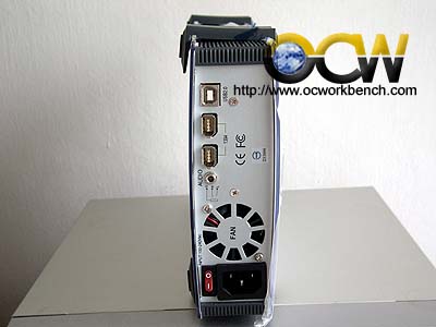

The back of the enclosure with 1 USB, 2 1394, 1 audio port,
power connector, power switch and the cooling fan.

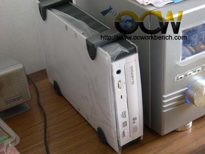

You can place the unit vertically or horizontally (as shown in the diagrams below)
