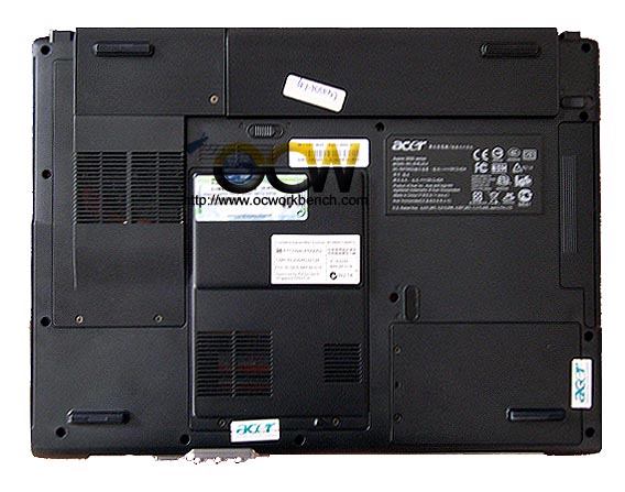

In the test, we attached a temperature probe from the multimeter at the bottom of our notebook, the Acer Aspire 3000 Sempron 2800+ notebook. The probe is put at the centre of notebook (That is where the OEM sticker is). We first let it run video streaming and surf the net as per normal usage, placing it on a normal desktop table. The temperature rised from the 33 Deg celsius to 48 Deg Celsius after 30 minutes of usage.
After that, we quickly removed the notebook and place it on the G-PAD. The temperature reading fluctuates for a while and starts dropping while video streaming is still continuing via the WiFi connection. We see a drop to a stable reading of around 40-41 Deg Celsius.
