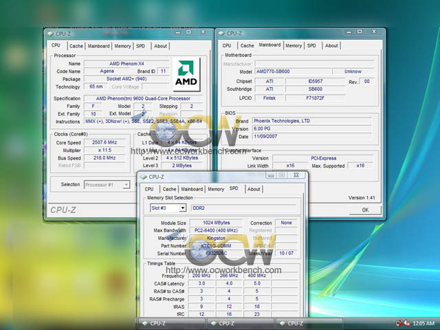

When we test it with the GP-9600 processor, we are able to only overclock it to 218MHz x 11.5 which gives us around 2.5GHz. As the multiplier option is available, we tried tuning the multiplier down. The CPU just refuse to go beyond the 220MHz mark. The situation seems to be the same with a Phenom 9500 on DFI 790FX board or the Phenom 9600 on Gigabyte 790FX. In another test to determine the max CPU CLK the board can achieve, we ended up overclocking the CPU to a max CLK of only 300MHz x 5 (low multiplier). Anything beyond 300MHz, the board just couldn't boot.

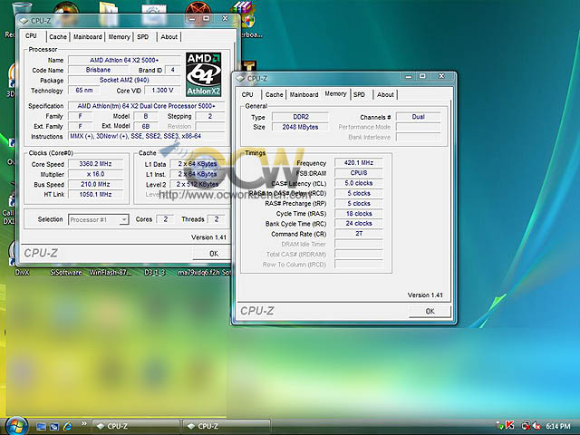

Although we are not very successful with the Phenom GP-9600 overclocking on the 770 or even other 790FX boards, the board did much better with our Black edition 5000+. We tested it on two situations, the first was to increase the multiplier, we were able to achieve 16.5 x 200. That is when the Vcore is set to 1.45v, the rest remains the same.
