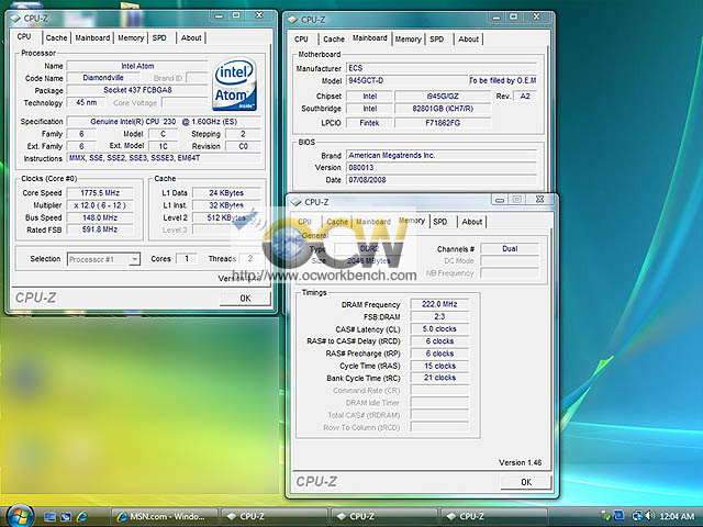

Something we tested is to overclock the board. As there are no voltage adjustments, we can only increase the FSB from 133 to 150MHz. At 150MHz, the system couldn't POST at all. We tested again and got it running at 145MHz.
