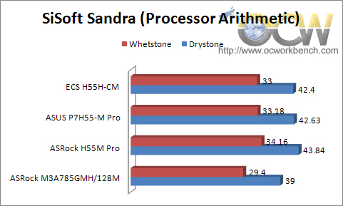

First, we check out the Processor Arithmetic scores of SiSoft Sandra 2009.
From the chart, we can clearly see that the difference in performance of the 3 boards. The ECS H55H-CM is definitely at a slight disadvantage as there are no options available in the BIOS to fine tune the ram timings. The ASUS P7H55-M Pro is slightly faster but it falls behind the ASRock H55M Pro largely due to ASRock's higher BCLK at 138MHz. When compared to the ASRock M3A785GMH/128M, the Intel Core i5-661 based systems are clearly leading the way.

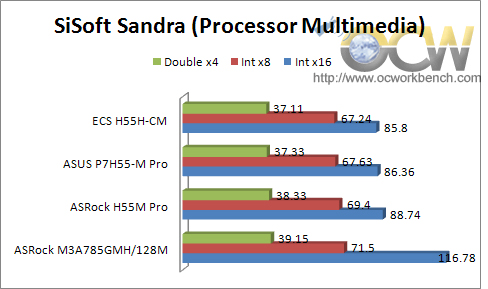

In the processor multimedia department, the same situation seems to affect the 3 Clarkdale boards. The 3 boards perform similarly but the differences are largely due to clock speed and ram timings. Surprisingly, the Phenom II X3 710 running on the ASRock M3A785GMH/128M is on par and even perform way better the Int x16 test.
