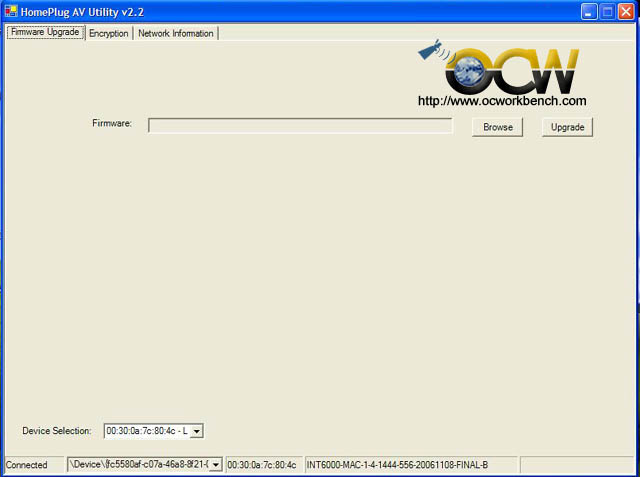

The package comes with a CD-ROM. Inside it is a the HomePlug AV Utility v2.2. This configuration utility allows you to update the firmware, check the network information, flash upgrade the firmware and set encryption.

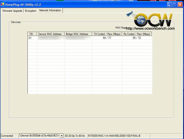

In the above screen, it shows the remote device. TX Codec/ Raw (Mbps) is the actual transmit bit rate and RX Coded/Raw(Mbps) is the actual receive bit rate. Looks like our electric cable isn't that good to achieve fast ethernet speed.

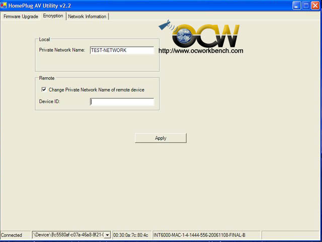

In the encryption tab, you can change the private network name for the Homeplug av devices within the network. Different names can be used to differentiate the indepedent networks within the network. It acts as an authentication.
You can upgrade the firmware of the local Homeplug or remote homeplug from this page.
